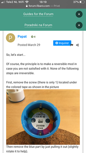

Like many others I struggled a lot with the range of x-wave. There for I bought some cheap range extenders -> Neo coolcam powerplug ( v1 and V2)
But both devices didn’t solve my problem, because the have very bad connection, so the are not good routers to my other Z-wave devices, placed further in my house.

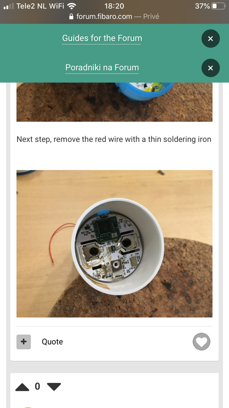

After testing/re-locating en googling, if found THE solution on an another forum:
After doing this, and a recreate of my Z-wave mesh (just waited a couple of days, so I didn’t force a ‘remesh’) every Z-wave device works perfect, really!
I hope I can helps someone with this info. It’s really easy to achieve!!
Credits to the forum seen on my screenshots

Which risk do you exactly mean? If I solder the new antenna, does electricity goes through the antenna, or only if you solder it not on the right spot?
I also found this link for another device
Another device mod
The Risk?
The 230v part is only a few mm (not even cm) away from your antenna solder connection, if you mess up and bridge the antenna with the 230v part, cause you don’t know what you are doing, don’t mind me if your house burns down.
Plus a warned user is always better then a burned user
As for your other post, he already mentions the warning at least 2 times himself that your working around parts that work on 230V
