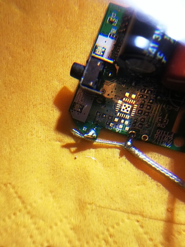

Mine looks like that:
Looks like you unsodered the antenna, and then took the pigtail and soldered it to where the antenna was, AND also to some hole a bit further. Is that something, that my module is missing and I won’t make it work, or is soldering to that hole optional?
The antenna shielding should be soldered to ground or GND. It is also possible without, but the performance will not be as high. You can use a multimeter to determine where you can find GND.
