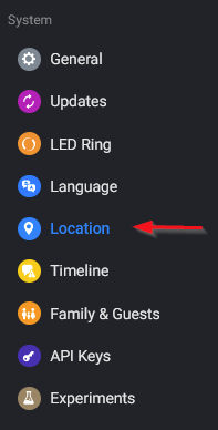

And Settings → Location → there you have specified your address, right ? If so, than it’s strange… you can always consider to you other aps like Smart Presence App for Homey | Homey but native location function works for me (at least on Android)
yup, that’s correct as well. Won’t post a screenshot for privacy reasons, but trust me that Homey’s location is correct :wink:
Will have a look at the smart presence app, thanks!
But it’s really strange, actually with new app and also maybe new Homey, it starts working for me even better then Smart Presence, so it’s surprising to hear that. But again, Android used here. Maybe someone else will share more.
Can you also check if re-entering position on My Homey helps ?
obrazek
It’s tricky as I don’t see Save button or something, but via pressing Enter I managed to keep the position updated (interestingly phone app shows correct position).
To be sure I’ve changed my location and then changed it back again to my home address, but unfortunately no differences. I’ve created a bug report, maybe Homey knows what’s going on.

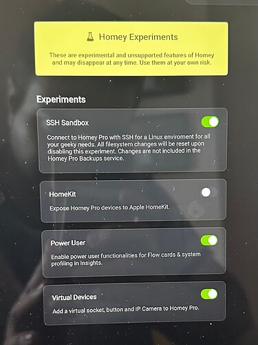

i have v10.0.0-rc.110 and how can I update firmware v10.0.0-rc114 ? because when I check, homey say is “no update”. my homey app on iOS is v7.1.0.
You must enable experimental updates on Homey Developer Tools
thank you very much
