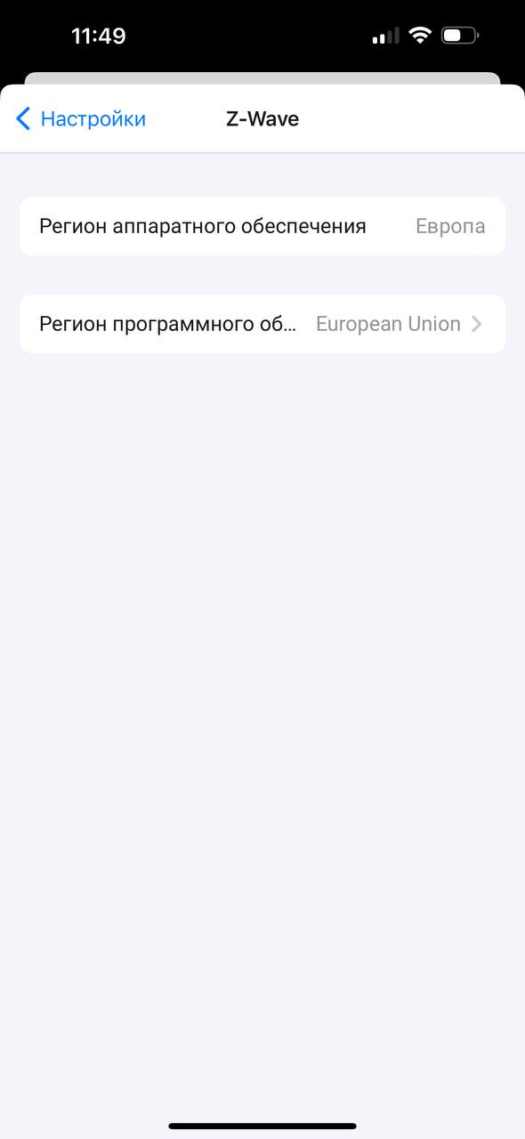

Hello! I just received my Homey Pro 2023 and ZWave region is locked in app, I can not change it to EU as I made on my old Homey Pro!
Left (Old Homey), Right (New Homey)
Found a way to bypass this, Turn Off Geolocation for Homey App, change in app geolocation to France for example, and set English, then restart Homey and ZWave Software Region will be EU, then I added all my EU devices and revert all settings and geolocation to my current. Now all works!
