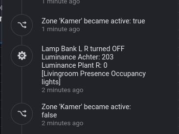

Anyone else has problems with the “this zone became active” cards? I have multiple times a day that this does not get triggered. Even though the zone is marked “active” and several sensors with a yellow “!” inside the zone.
Did you try the Device Capabilities app, maybe this also works on a 2023 (don’t own one):
Screenshot from 2023-04-09 07-47-52
