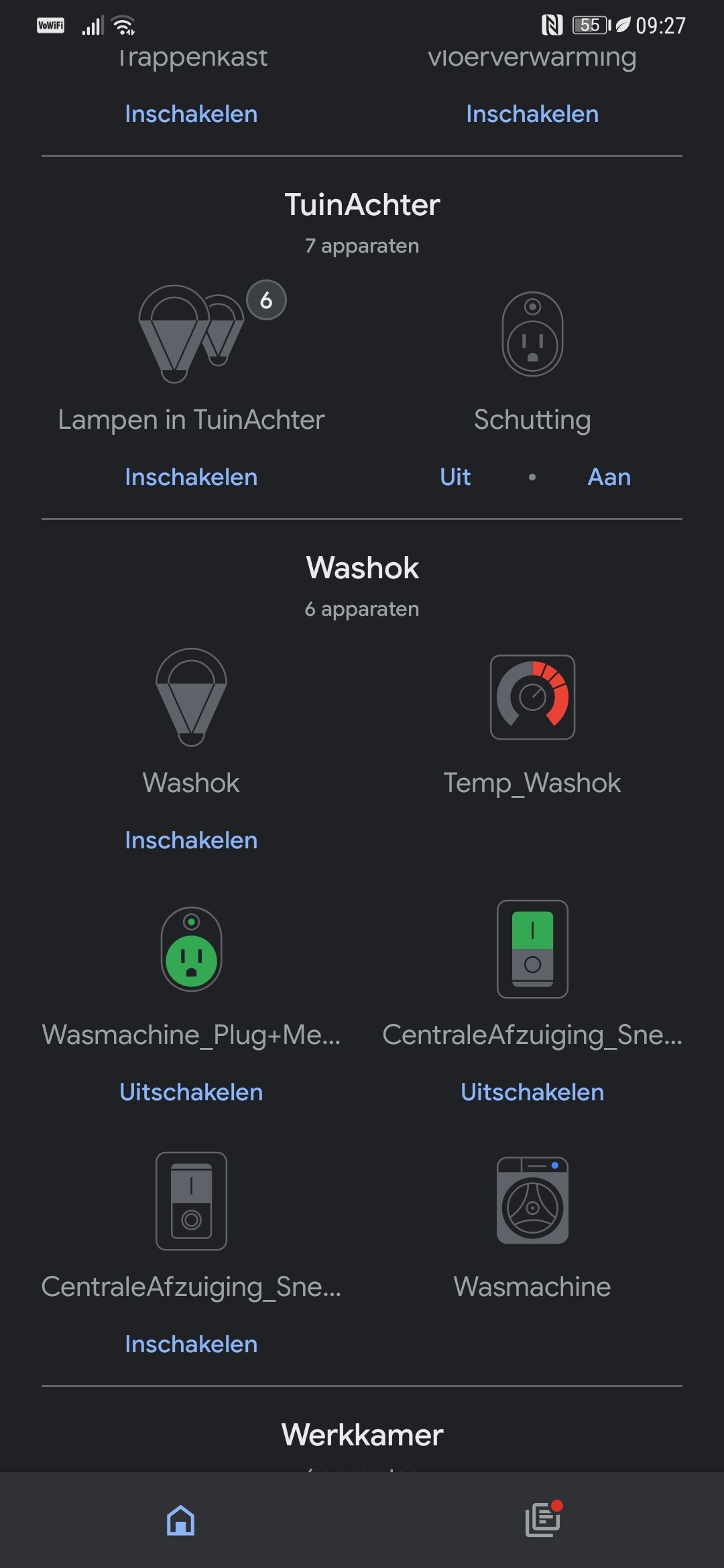

This is my view from google

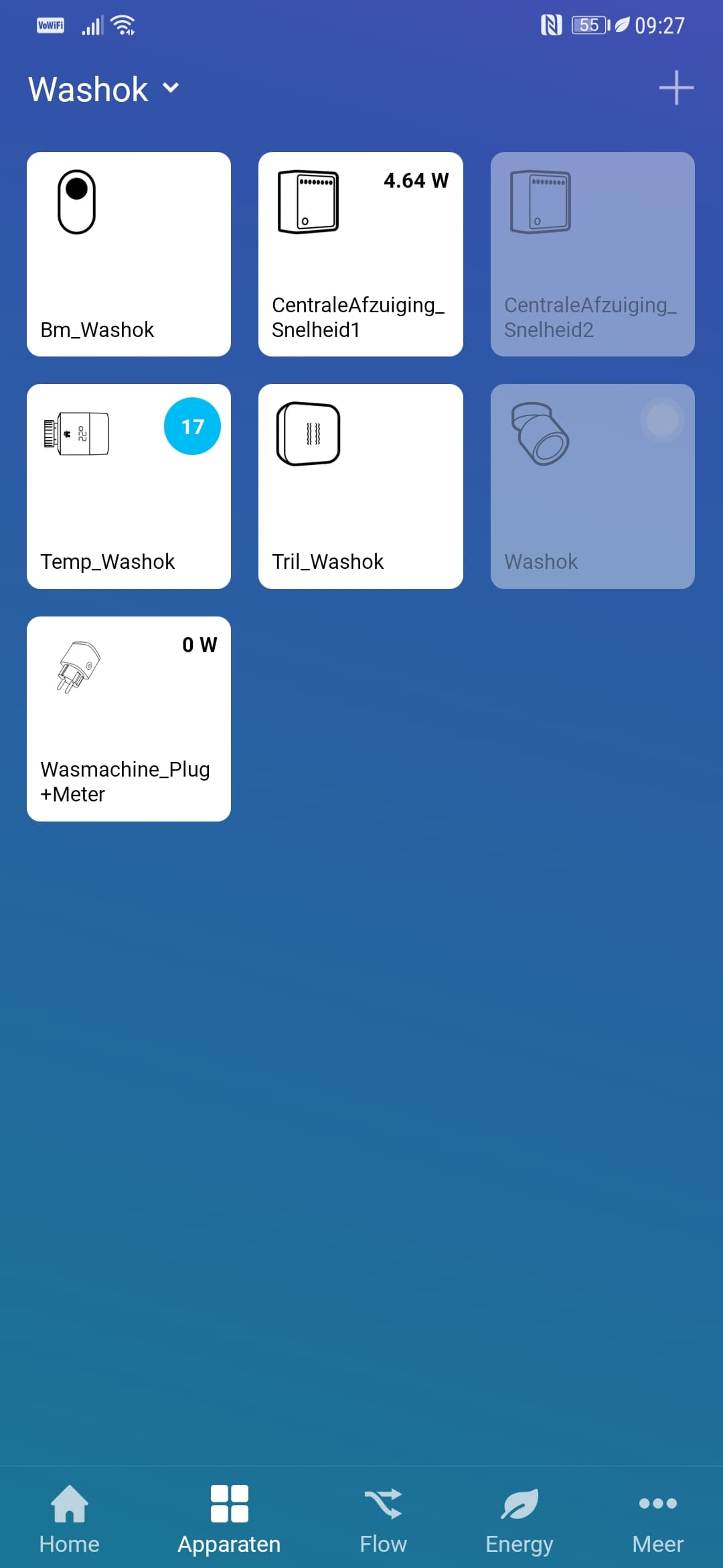

View in Homey app
In both i do see in the room Washok with sensor “Temp_Washok”
