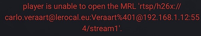

Just received the info that Taco camera’s are supported in Homey Pro. I installed, direct connection, but ‘live’ view is not working. See added print screen. Did I forgot something? How to finetune? Thanks for your quick reply? PS the camera installed as IP virtual is working fine (but than no cards)
The RTSP format is incorrect in the part before the IP address, Carlo.
rtsp://username:password@camera_IP_adres:554/arguments
Yours has two @ signs in it… because you have an email address as your username:
carlo.veraart@lerocal.eu:Veraart%401@camera_IP_adres:554
The simplest solution, as far as I know, is to change or create a new username such as ‘carlov’ or ‘carloveraart’ or something similar.
Do not use ‘@’ or ‘:’ in the name or password.
You need to create a local camera account in the Tapo app (Advanced Settings in the Tapo app)
You can’t use your TP-Link ID for the RTSP stream

But it looks like the email address is a TP-Link ID (account) login, which won’t work since the RTSP stream of the Tapo camera requires creating a local “Camera account“ in the Tapo mobile app
I get “Invalid URL” when using this format: rtsp/h26x://username:password@cameraIP:554/args
Plus having 2 @ in the user:pass@ part won’t work anyway.

rtsp://carlo.veraart@lerocal.eu:kekxes-gotgy1-rExdot@lerocal.hopto.org:554/stream1

You should first add a local account, like Sven suggested.

You should go in the Tapo mobile app to your device → Settings icon in the top right corner → Advanced Settings → Camera account
