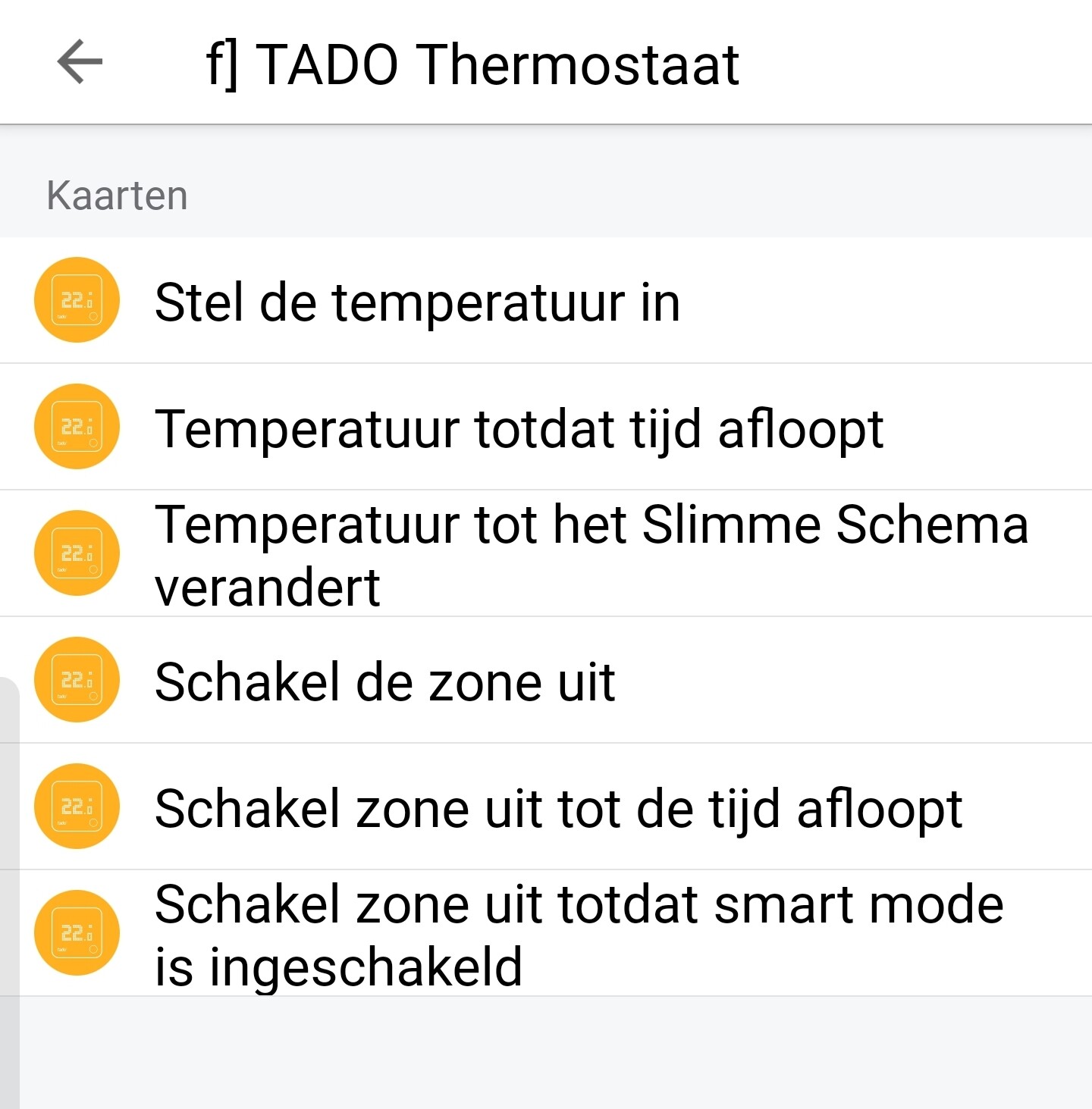

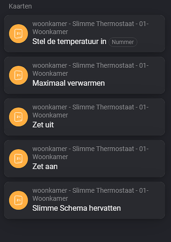

But, after checking with the standard flow editor, I can select zones ? It suddenly works. Yesterday it didn’t.

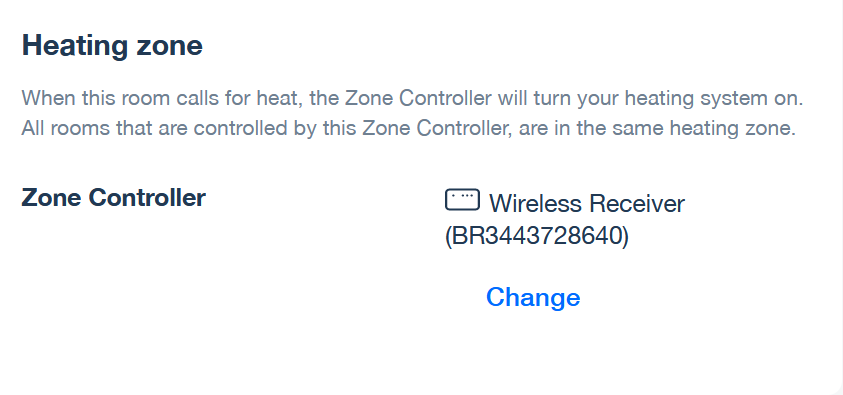

This (screenshot below) is explained on the app page. Since I have not yet configured a zone with multiple tado devices in it (in tado app), I obviously can’t add a zone yet. A zone with one device is equal to the device itself. I was confused before, but now I think I understand how it works :wink:
I’m not sure what you mean. In Tado, I have 5 rooms and a “hot water” zone. One of those rooms (“slaapkamer”) has 2 devices (smart radiator valves), the rest has just 1.

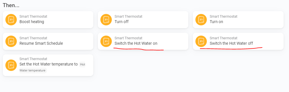

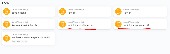

Hi, I’d like to ask what I’m doing wrong. I am also using Tado to control the hot water boiler. After updating Homey Tado to version 1.1.2 it should offer “Switch the Hot Water on” and “Switch the Hot Water off” (screenshot)
. Unfortunately I don’t know why, but in my flows I only have the option “Set the Hot Water temperature to”. I also tried uninstalling the app and logging back in, but nothing changed. Does anyone have a similar experience?
Same here, we have to complain to Athom. Promised cards are not available
