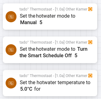

Screenshot from 2022-09-16 16-12-10
It is not ‘really’ OFF indeed, but I consider water of 5 °C as not ever going to be / need to be heated :grimacing:
I don’t think tado turns the Hotwatermode Off when it reached the target temperature. When it’s status is Smart Schedule, it keeps the water on a target temperature, but it’s not continuous heating.

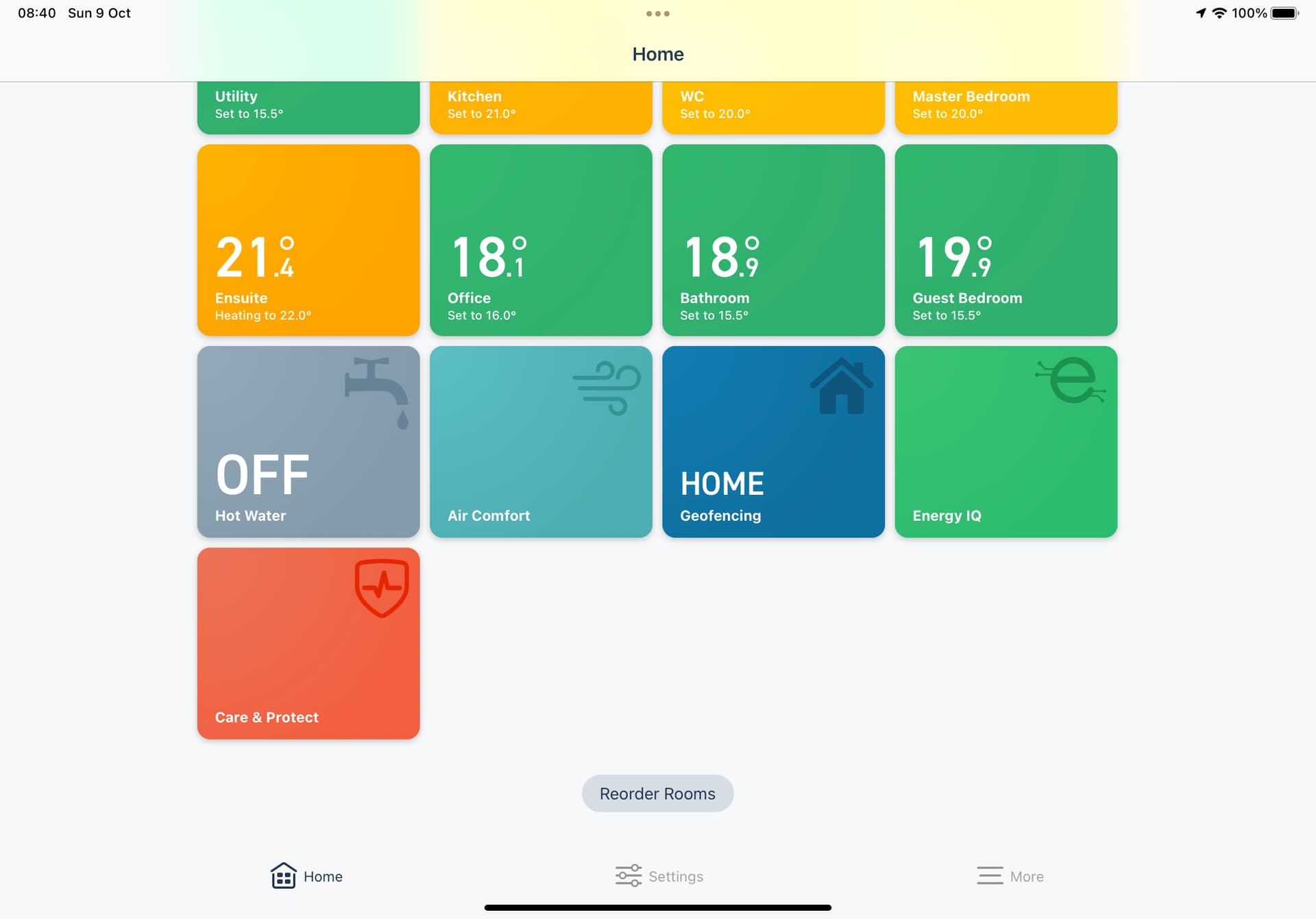

@Busta999 I suspect you have what I have which is a full Tado system including Hot Water Extension to enable sending hot water to storage tank and not radiators. In the Tado phone app I can turn on Hot Water by itself and not rads
This topic is marked as solved when it is not
Mine looks like yours, I can control and schedule Hot Water.
Just can’t see how to control hot water in Homey.
This won’t let me add a second photo, so will add it in the next post
From having wondered about this months and months ago I’m not sure how much of Europe actually had hot water storage tanks. Discussing this seems to confuse many who assume that hot water all goes to radiators. But it does indeed look like we have the same set up
