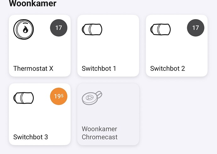

Hi Dferch I was able to save the flow. yet doesn’t seem to be working when changing the temperature in the app.
As you can see I changed the thermostat to 17 but switchbot 3 stays on 17
Have you checked to make sure the tile is showing the target temperature and not the measured temperature?
I think I found the problem. As being new i did not see that those labels are linked to devices and I connected them to the wrong devices. I was also able to create it as a simple flow allowing me to try from the phone untill it worked :wink:
Now it seems to work nicely
