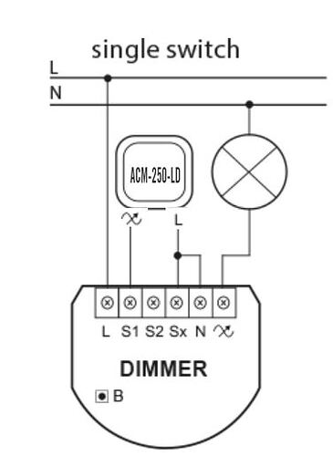

Last option would be to put a KAKU dimmer switch in the central cabinet, which could serve as receiver for the KAKU dimmer in the living room. This receiver would then act as the switch, connected to the Fibaro dimmer which is there (I do would like to keep that Fibaro, for the feedback to homey). Created a scheme. But seems quite excessive:
Other thoughts?
thanks,
I doubt that the Fibaro dimmer will accept a dimmer output as its switch input.
Ideally, you need a dimmer that can be associated directly with the Fibaro dimmer over Z-Wave to control it. Or a Z-Wave dimmer with a built-in turn knob (like Ecodim or ROBB Smart).
