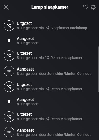

When these lights are set via a flow to dim level XX%, they turn on but not allways to the set dim level. They turn on at the last used dim level, or at dim level 100%. This happens random.
Above the device log of one of these lights, while I was trying to trigger this behaviour.
I see a difference where sometimes the device is controlled via Schneider/ Merten Connect, and sometimes just ‘turned on’.
Below an example of the flow:
Am I doing something wrong, or are other people experiencing the same issues?
And more important; is there a possible fix :slight_smile:
