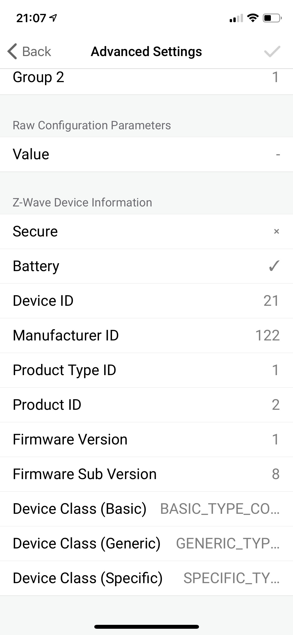

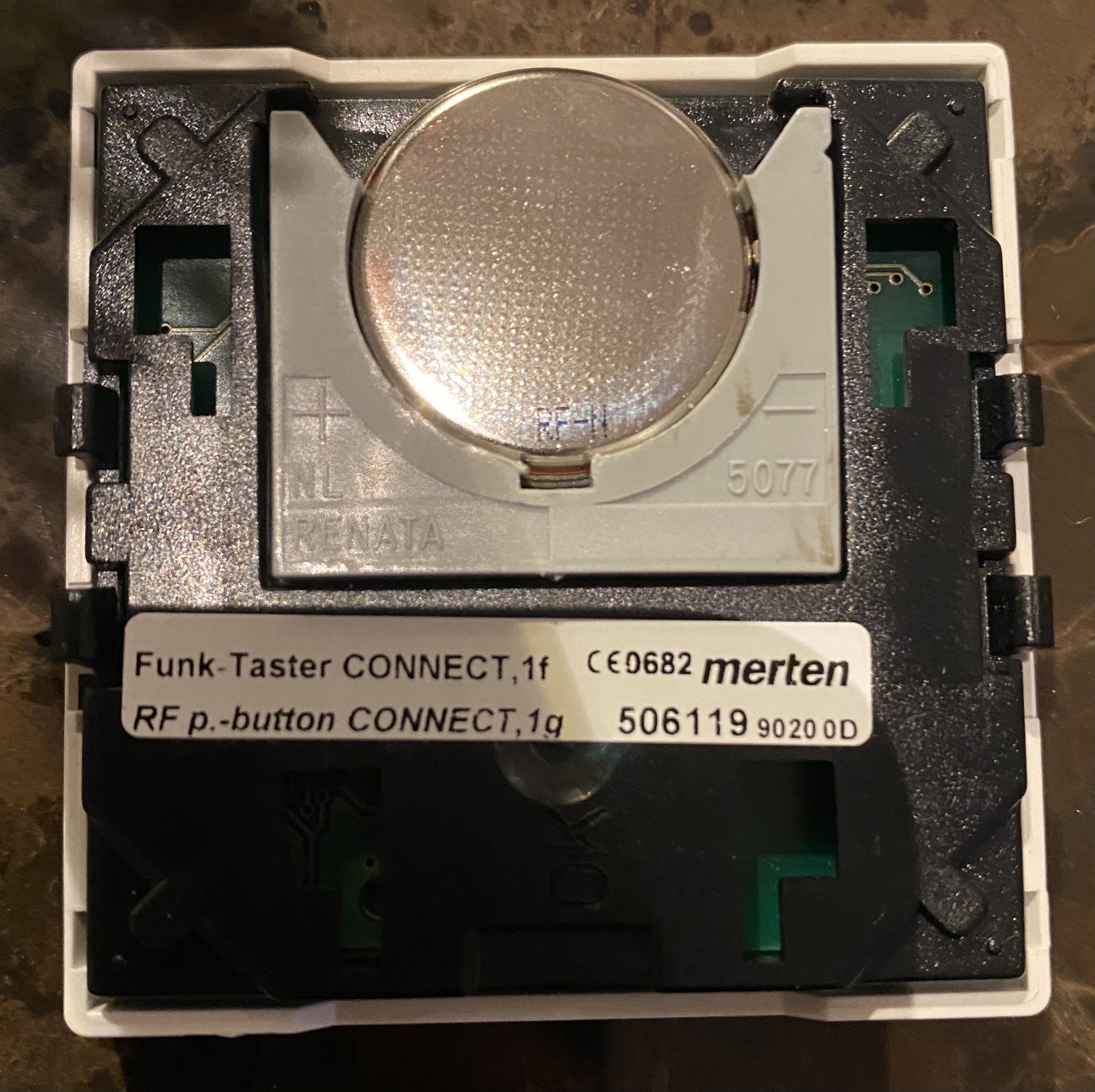

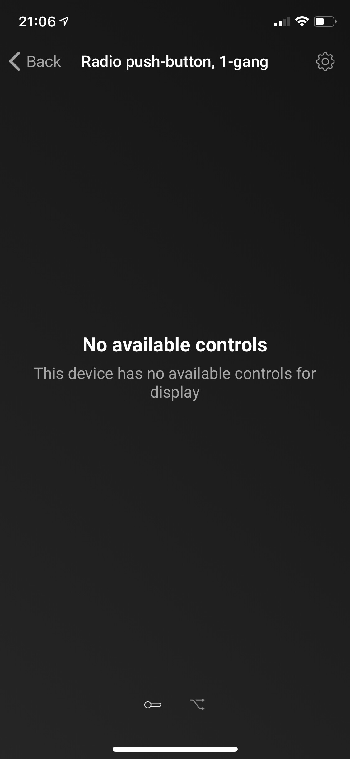

I installed your app and and the dimmer is working perfect and I can control it from the app. I only have a problem with the radio push button 1 gang. I can easy add the device to homey only I cannot control/use the push button. I have added the push button after the dimmer and the device number is higher. Also the push button is not visible between the devices when I try to make a flow. Maybe I am doing something wrong.
I have attached a few screenshots from the homey app and the push button for your reference.
If you need more information please let me know.
Best regards and thank you for working on this app for the older merten devices
Robert
Yes, the Schneider/Merten pushbuttons are a bit specific. In this version of the app, they can only be used when connected directly to another Schneider/Merten device.
If you want to connect the pushbutton to your dimmer, you need to enter the dimmer’s device id manually into association group 1 and 2 of the pushbutton. This is so far the only way I managed to keep the full dimming function of these devices.
I will research this a bit more, but it seems that the dimming function will not work with other devices than Schneider’s own. If you add more id:s into the association groups, the dimming function will stop working.

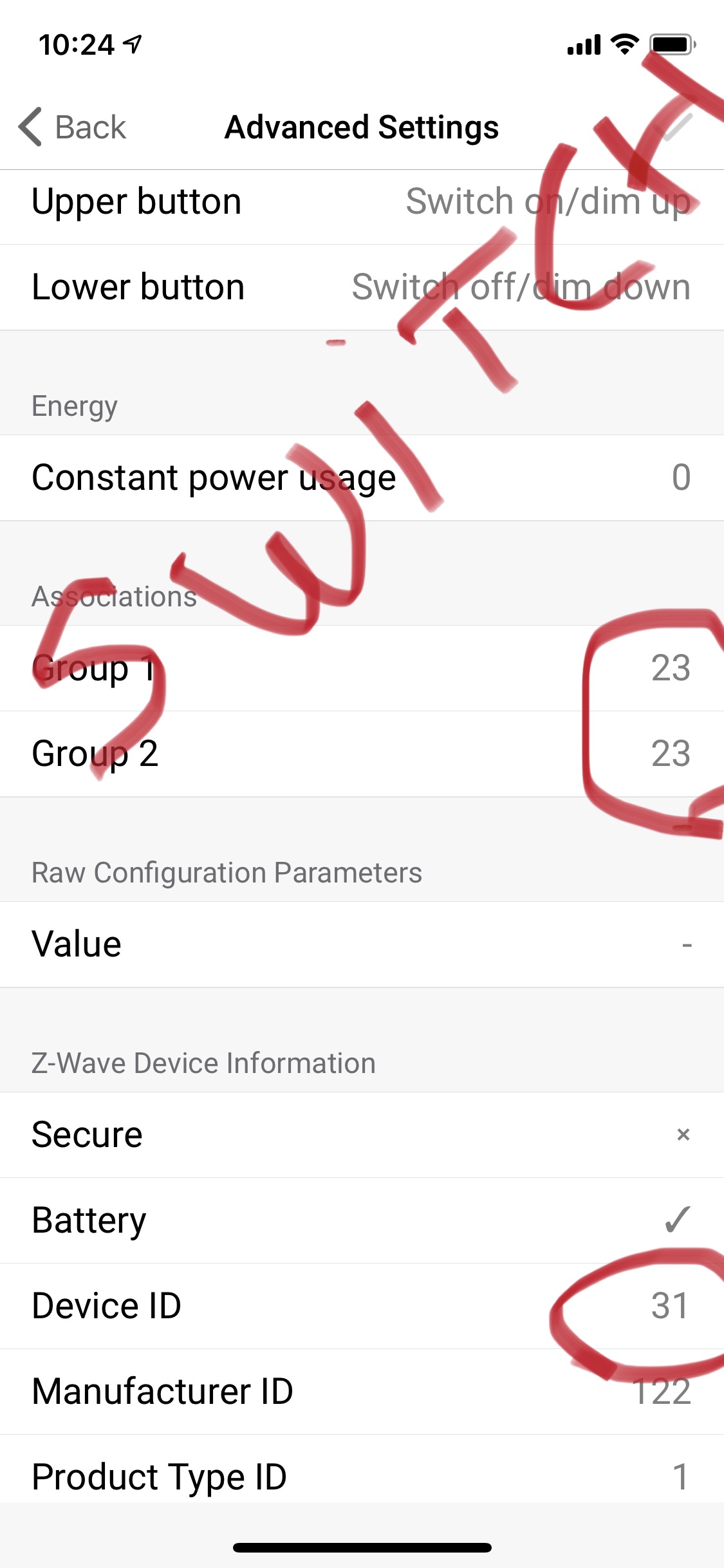

I have added the dimmers device ID manually in the dimmer and the push button. I needed to switch the dimmer manually on an off with the my.homey.app browser and for now it is working perfect.

Inclusion for me is working fine I followed the explanation from Stefan above only sometimes you need to try it few times. I attached screenshots from how I setup the dimmer and push button in homey app. Important is what Stefan is saying is that you first need to add the dimmer and then the push button. the push button device number must be higher.
@Stefan_Ekstam only problem I am facing is that after a few hours the connection between the push button and dimmer is lost. The only way to get it working again is to switch the power from the dimmer off and on and then it is working again for a few hours.
