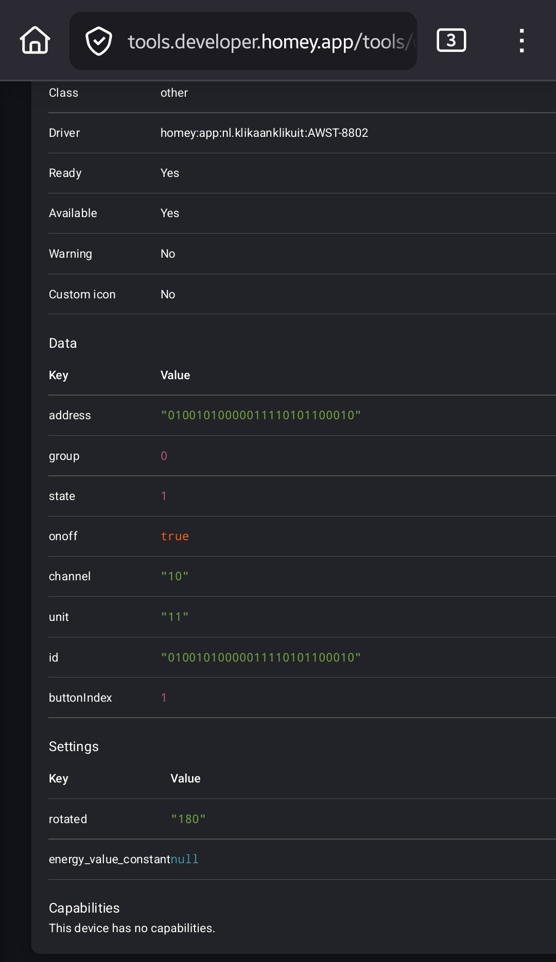

3rd
@ tools.developer.homey.app/tools/devices you can see it’s data, but nothing changes when operating the button
(Funny: it has no capabilities, but it can trigger flows anyhow? Right…)
