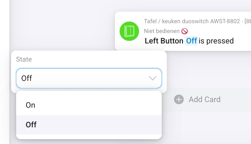

Did you try reversing on and off?

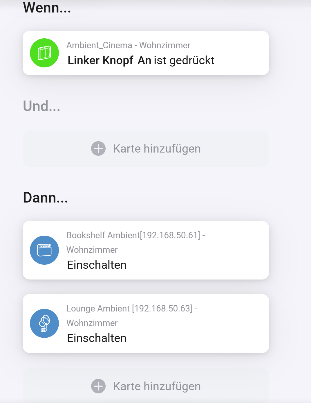

Hi Dirk,
Here is the screenshot of the flow, really simple, but only working in the app, not by pushing the button
Thanks for taking a look…
Yes I did try that, also the option of the switch being mounted upside down (which isn’t the case) but no effect….
Hi Ulrich,
Thank you for sharing the flow. It looks quite straight forward.
Can you see the state of the button in the devices section? Is there a proof that Homey recognised the button being pushed?
