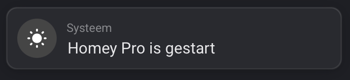

There is a build in card in the System section, WHEN ‘Homey Pro is started’:
Note that you need to enable the Power User-function first in order for the card to show up. You’ll find that function in Settings in the Experiments section.
