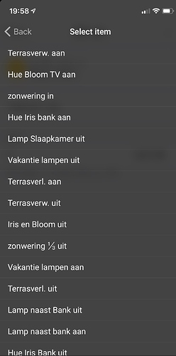

As a workaround when you have the Tahoma Box you can make flows in Homey that trigger the devices added to the Tahoma Box.(Somfy Tahoma App)

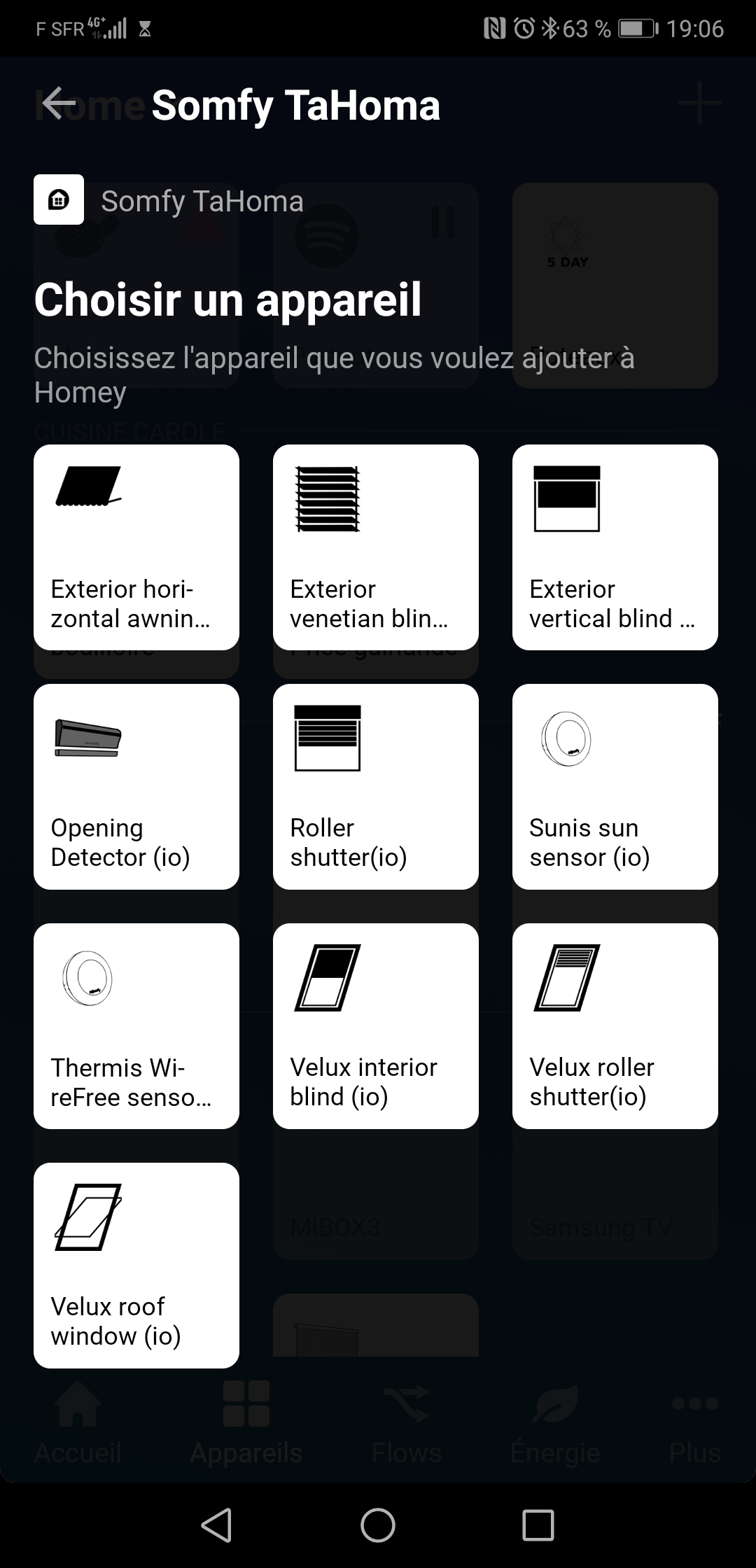

Thé Somfy tahoma is not the good solution because it doesn’t recognize RTS shutters. Only my io temp sensor is recognized.
I do not understand why RTS doesn’t make part of the recognized object. Only io device are shown (cr screenshot)

The somfy tahoma app only shows io devices, but you get the possibility to use the scenarios you made in the Tahomabox
Yes I found that but I would like to control my device directly in the homey app without making a flow to monitor a tahoma scenario…
