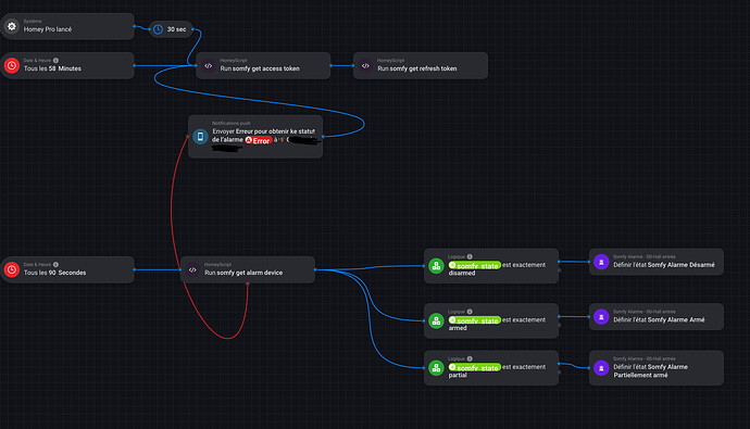

I made homey script in advanced flow to call the api and activate alarm mode, and it works.

The scripts are there: GitHub - coolweb/homeySomfyAlarmScripts: Homey flow scripts to use somfy home alarm (myfox)

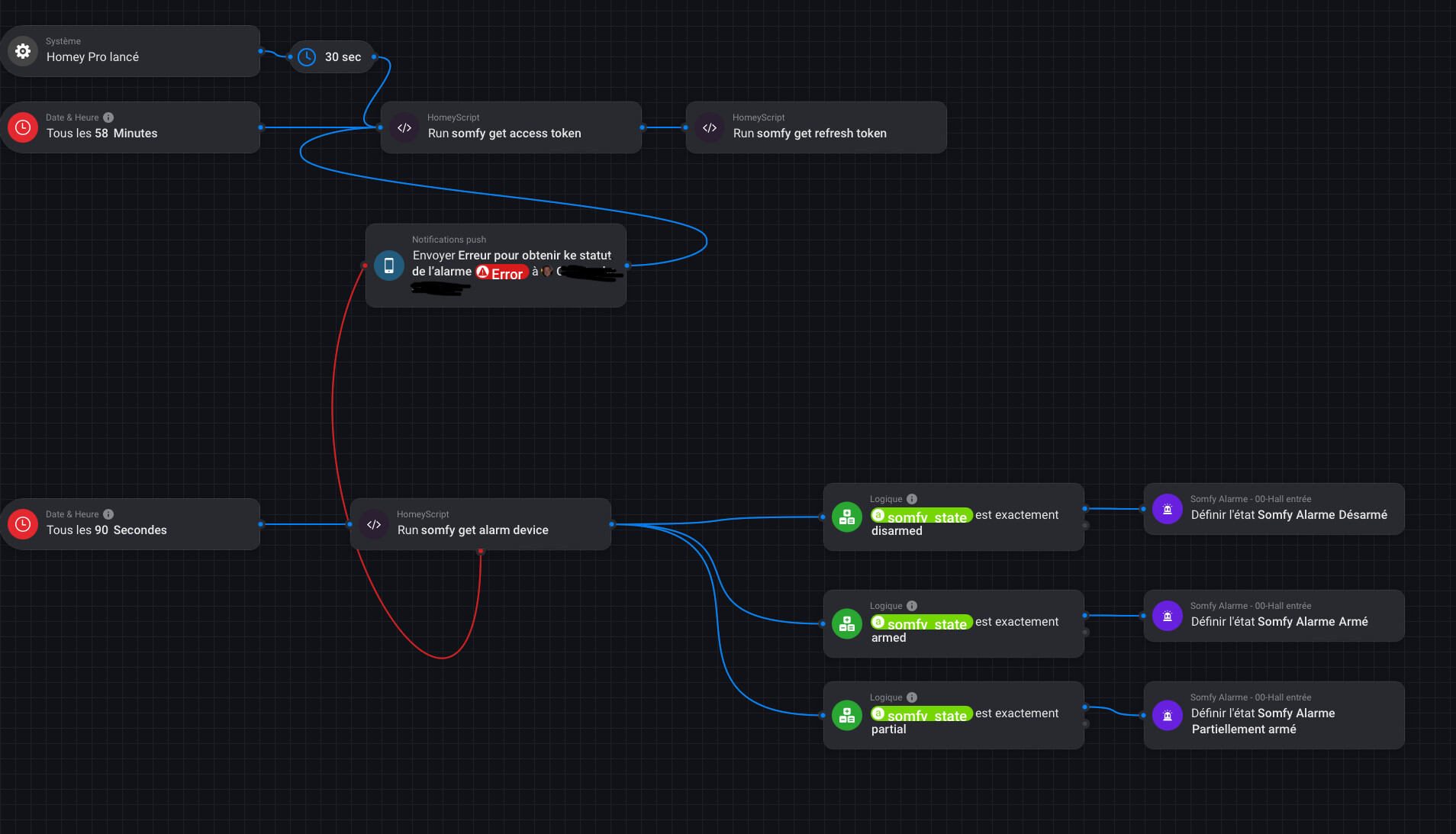

My flows:
Thank you very much, I can activate my alarm now :slight_smile:
