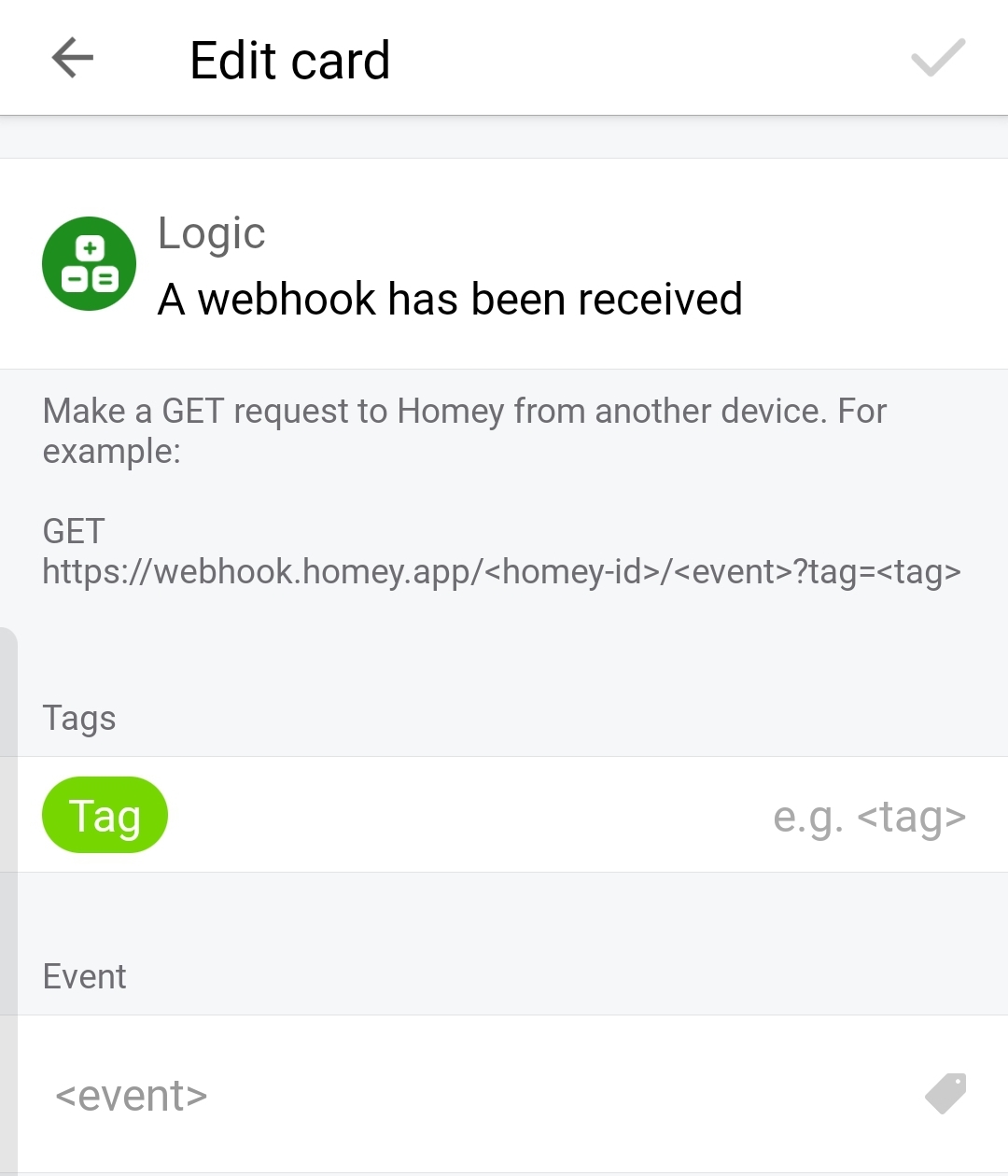

I have a flow card that is triggered from a Logic GET-request.
GET https://webhook.homey.app//?tag=
Whenever a request is made to the URL, a push notification is sent to my mobile. It all works fine.

Yes. And since the endpoint contains your Homey ID, they only have to know the URL.
It could be an innocent situation where the URL has somehow leaked and now it’s being indexed by a search engine, for instance.
That’s why it’s common that webhooks only work with POST requests, which search engines typically don’t index.
Not AFAIK.
And I think when you use this trigger card
changing all of your current event and tag descriptions, is the only and easiest way to stop these flows from being triggered.
You can’t trigger flows without at least a matching event description.
Other option, request a new homeyID;
But little chance (=assumption) Athom can change or wants to change your homeyID
