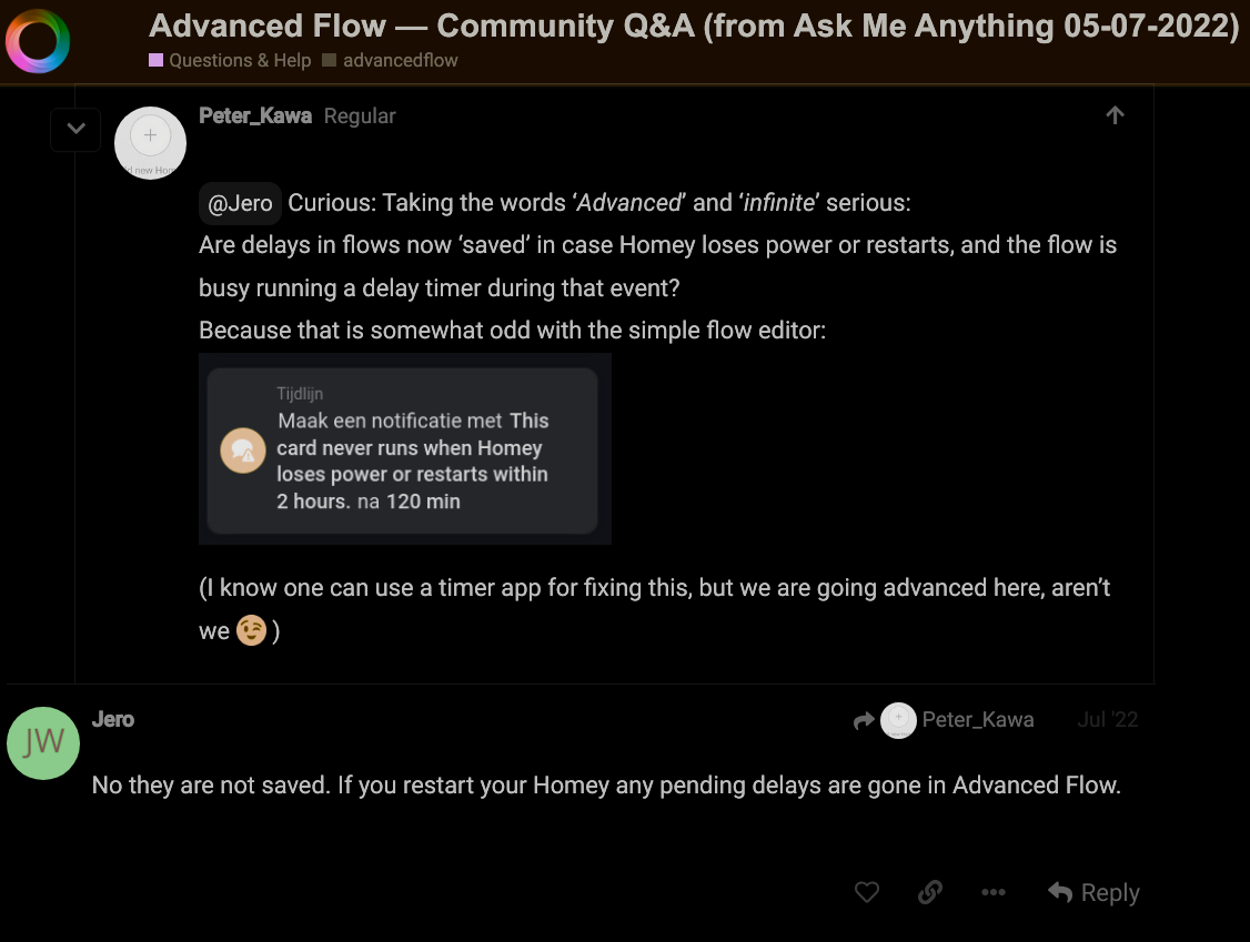

I asked about it, at the time advanced flow was introduced. Seems not important to Athom:
So, in my humble opinion, those delays are fine to use when the duration is one to a few seconds; the longer the delay time, the bigger the chance your flows don’t finish after a reboot.
