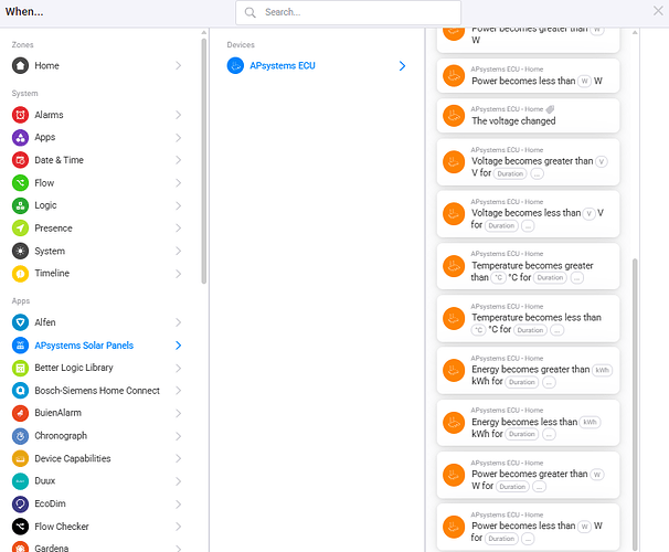

Hi @Dick_J ,
is it possible to in the when cards, add the option to check when the power has changed?
the strange thing is I do see it on your app page:
But don’t see it in the list:
Hi Patrick,
The cards are actually from Homey and come standard with an energy application I believe. I didn’t make them. Recently, Homey changed some of the standards and maybe discarded the one you mentioned.
I will look into this and maybe create such a card.

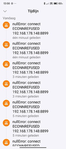

Hi Dick good afternoon, since your last update Sep-06 I receive all these error’s , see screenshot.
Best regards Peter.
Same here
By the way, I do see a very unstable connection. I have made extensive flows checking that the data is being received and if needed reset the app or the router (which was happening a lot as well).
Question this is, is the app creating the disconnects, or is the connection/wifi not stable, leading to the issues.

I think that the ECU connection is inherently unstable. The error from your diagnostics is:
This is also happening at my ECU. Powercycling the ECU resolves that. I don’t know why this happens. I have asked APS twice to supply info about commands to the ECU, but they didn’t reply.
Other strange things happen also. I regularly see a reported generated power above 50MW in the energy tab. Sometimes a connection error, sometimes a timeout error. :zany_face:

Alsowent back to the installer for the instability and he opened a complaint at the supplier. Only heard back that everything is oke….
Question is where the instability comes from. Panels to the ECU router, or router to internet. I feel it’s the former, so will also place the router closer to the panels.

Did a full reset, including homey, the app and the ECU. now it is working again. Also sent a diagnostics report and replaced the ECU closer to the panel to hopefully increase the stability of the connection….
fingers crossed
Oke, too early, having many disconnects again
I had a Odido klik-en-klaar modem next to the ECU and moved it away 10cm. It may have interfered with something in the ECU, it seems that the disconnects decreased.
Also, I aplogize for publishing a wrong version.Yes, there is a card to trigger when the power has changed, but I putted in a random number for testing purposes. The displayed power therefor made no sense.
Did a quick fix, hoping that I didn’t break anything else :crossed_fingers:
