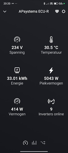

I’ve got only 5 inverter’s online it says in the app see screenshot, but I checked in EMA app and all the 9 inverters working normally. And actual power in EMA is 1384 W

Hi Peter, the amount of inverters online is a momentary situation. I noticed that not all the inverters report back to the ECU, when I queried the ECU. It’s not that they don’t work anymore. It was mainly for myself to see if inverters were sending or not. It’s a bit confusing, I will leave it out in a future version.

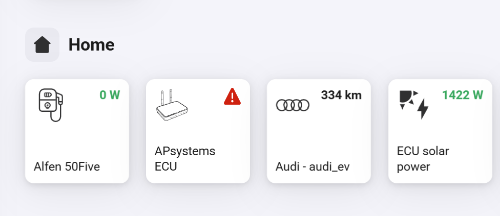

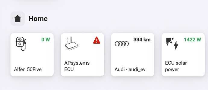

@Dick_J , what do you advise? Do I remove and re-add the ECU, or do you think with the next version it can self repair? on my side it is still offline:
Hi Patrick, can you send a diagnostics report? Maybe there is something in there that can give a clue.
You can also try to delete and reinstall the app.
Hi Patrick, mine was also not responding after the update, I readded the ECU-R and everything was fine after.
Good luck and regards Peter.
Did a diagnostic report.
Also removed the app and reinstalled. Now was able to add the ecu and get it to work :+1:t2::+1:t2::+1:t2:
Great. Although I hoped that only reinstalling the app would have been enough. In the diagnostics report there is only one thing that was odd; a capability that I thought was deleted.

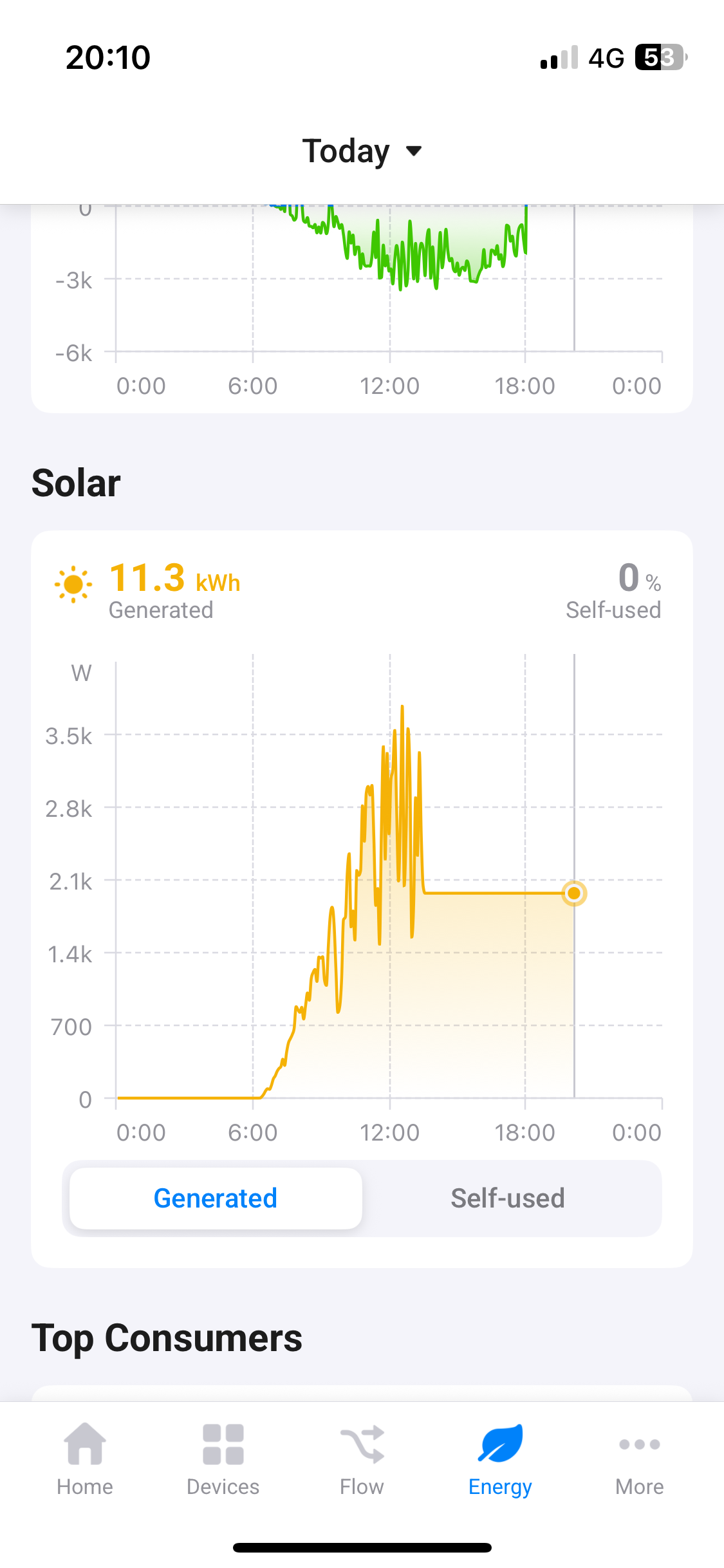

I am facing an issue : data is not being updated after 24 hours
These are the values for yesterday… the screenshot is from just now

Hi Greg, unfortunately the diagnostics report doesn’t reveal much. There was a command sent to the ECU, but it did not respond it seems.
I also encounter some problems with the app every now and then. The output seems to freeze; constant power over a long period of time. Today my peak power was 500MW….
Stil work in progress I’m afraid, and I noticed that the ECU itself is not very stable. I unplugged the wired internet connection now, to see if that makes a difference.
