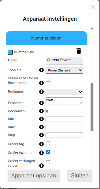

  1. create a new ā€œdevice capabilitiesā€ Device and give it a name.
  2. repair the device and in this screen add a numeric value:

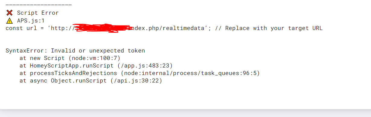

I tried to implement the Script, but when I test it i get this:
any idea? many thx
Scripting is new for me…

The script does work but I have my doubts that the text comes through as expected:
I have added the code in a txt file, hope that works better :

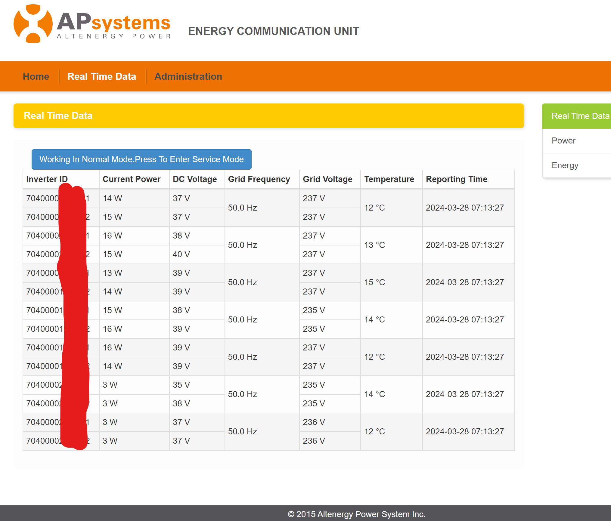

I have the ECU-R, not sure what firmware as it still states copyright 2015 in the botom of the webpage. However, if the page looks like this, i guess it should work:
If it looks different, send me an export of the html and ill see what i can do to parse it.
