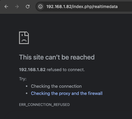

Can you make a printscreen from the following:
http://192.168.1.82/index.php/realtimedata

It doesn’t seem to connect to this URL, although my ECU-R is perfectly accessible via the EMA App. Furthermore, I have recently set up an active API connection via HomeWizard’s Energy App that works perfectly, although it only updates every 15 minutes. When I try to ping the IP everything looks good. Very strange.
This has been my problem from the beginning. The website is not accessable from within my home (eventhough the ip address is visible in my ubiquity system). Also adding the varios mentioned ports here and on Github do not give me access. hence any and all script fails, as they cannot get any data from the website…
Anybody getting data from their ECU-R through the internal IP address?

I noticed that the ECU-R has a poor uptime when connected via wireless. The moment I switched to a wired connection, the uptime was 100%. Please note that the IP adress will change the moment you switch to a cabel connection, so the url needs to be adjusted accordingly.
Please note that my script crawls this page and calculates all values from the Current Power column. If the page is inaccessible, the script will fail to function. Therefore, it is essential that this page loads correctly.
Since it almost dark right now you will not see any power
