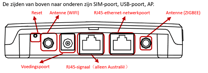

My installer mentions that connection through the LAN port should work, and better than WiFi…. But connecting to LAN does not work? did you connect the correct LAN?
Also the ECU connects through Zigbee to the converters. no way to connect to them directly? I don’t think they have any form of an API for that….
Yes I did. The other RJ45 can be used for Modbus. The LAN port works fine for the communication to APS and the website. There are two ports open, which did not respond to the commands like the WiFi does.
The Zigbee signals can be read, but that would require additional hardware. Though it might be interesting to see if Homey can connect. But I’m sure setup will be a bit more difficult.

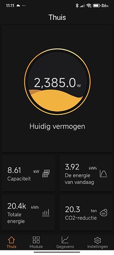

Hi Dick, I still don’t receive any reading’s from the ECU-R any more while the data is still being processed in the original APsystems app, see screenshots and I made a diagnostic report to.
ff60e6fb-a1a8-41a6-a6ef-505f115f8f95
I’ve restarted the app several times but no luck.
Best regards Peter.
In my case if this happens, I have to do a power cycle of the ECU unit. It happened often, and thus put a mains switch on the ECU and cycle that automatically if that happens
Hi Patrick thanks for your reply.
And I also found out that restarting the ECU-R by disconnecting the power plug solve the problem but it’s not normal because it’s still sending the correct data without restarting the ECU-R to the APsystems servers and have the actual readings in the APsystems app.
