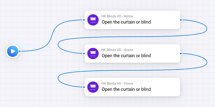

You mean you have a flow that opens or closes all three blinds at the same time?
If that’s the case, then that’s “normal”, in the sense that Homey hasn’t been able to control multiple devices from the same flow for many many years (and Athom seems to be unable/unwilling to fix this).
The common way around this is to introduce delays in between the action cards, or (possibly) chain them in an advanced flow:
Not this:
But this:
(however, this depends on the exact implementation of the card and whether it waits for the blind to open before continuing to the next)
