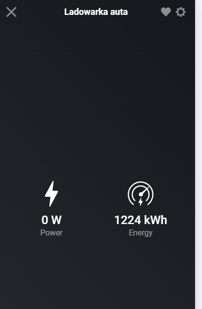

i recently connected some no name power socket with energy meter and it works good with homey but the problem is in energy counter(the power meter is all good). The counter is counting 100 times too much KWh. I have connected car charger to that socket and it was working for 6 hours with 2KW power but the counter says it consumed 1224Kwh. I cannot find any setting for that one…

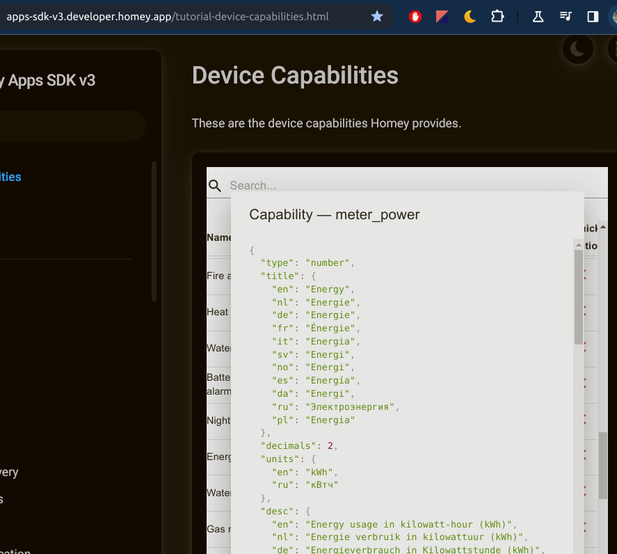

Firmware v10.1.0 supports generic zigbee power measurements:
Source

I analyzed this for the Tuya device I had problems with. It simply reports the Wh output instead of kWh, as it seems. Dividing it by 100 when reading the reports fixed it (in the device driver in the Tuya app).
I don’t think this can be fixed for a generic Zigbee device (if the standard unit is kWh for Zigbee power_meter, which I am not sure of).
Yes, the default unit for meter_power is kWh
