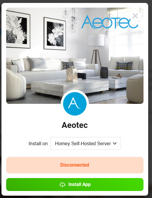

SHS and Aeotec Error when installing?
Hello, I am wondering if anyone has seen this error when adding Aeotec app to SHS?+updates

This app installs fine.
“Disconnected” means the app store can’t reach your Homey SHS!
(I didn’t do anything special for SHS to be reachable by the homey.app store)
I was able to get Aeotec installed after several random tries, im guessing the USA system was just to busy at the times i tried, i had to send a diagnostics report though because i can not add any Aeotec devices, but its progress!!..
