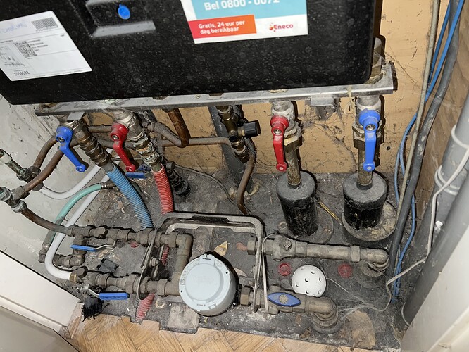

Don’t have a boiler as we are connected to the city heating system ( hot water comes from outside ) but still… I should be able to see if the hot water is running. But not sure how to “sense” the hot water is flowing
Any meter or whatever for the hot water. How is this connected versus the heating of your house ?
Heat exchanger ?
There’s a box from the hot water provider aswell… apparently they are able to read the data from their box…
This is amazing! Whish I had a boiler now :joy:
I do seem to have a smart water module! Didn’t know
Might be able to get info from there
No… it can read it every 15 min… that’s not fast enough

I think you’ll get back to one solid solution. If you want to know if water is running, you do need a flowmeter.
But you could fit one in the kabinet instead of in the shower.
It’ll look beter thdn in the shower and you’ll need only one instead of two…
