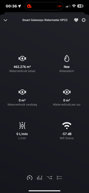

I have a Hue outdoor motion sensor in my shower and also a meter of my (total) water consumption by smartgateways(.nl) (and additional I used also a waterleak sensor in my shower.)
With these 3 sensors you could use any combination of at least 2 of them to determine if some is in abd/ir using the shower.
Motion + Water consumption total number is increasing OR
Water leak alarm + motion OR
Water consumption total number us increasing +Water leak alarm.

That sounds great! How do you know (fast) that the shower is off?
The water ;consumption sensor has also a value how much liters oer minute is currently consumed so apparently after max a minute I know that the shower is off when it decreases significantly.
