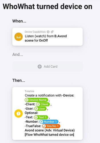

you can place a text-variable in between the text, change the content of the text-variable before sending the text.
Do you have a example (flow)?
This adds the variable data (text/numbers/TrueFalse) to the entered fixed text.
So no matter what the variables data is, at the time of the flow trigger their current value gets “printed”
