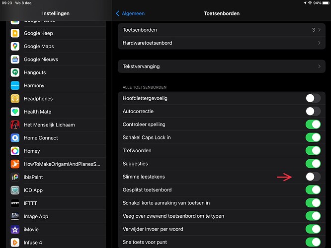

These come straight from the keyboard, don’t know how else to enter them.
Perhaps it’s the rendering that makes them look like smart quotes, but they look suspicious. Try pasting this after the tag:
? "open" : "dicht"
You’re right, somehow on IOS/iPad both the on screen keyboard and the typecover are being smart-asses, both in the app and safari/web app. With plain quotes it works.
Ah, found it. There’s an option to get stupid quotes. You can decide which option you think is the stupid one :stuck_out_tongue_winking_eye:
