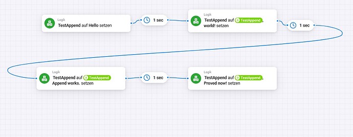

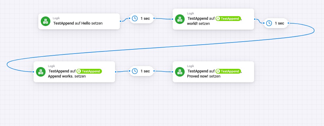

Works well: Shared Flow | Homey
Or advanced
You just need to ensure, that there is some time difference with the “append” step. because all cards would be executed simultaneously and the outcome is undetermined.
That is so easy. Never knew you could do that with logic and text variables. Thanks! :slight_smile:
