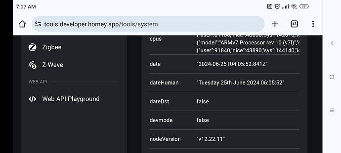

Nevermind … it was a one hour delay between real time and the time in developer tools and i assume it is the daylight saving so all i need to do is to always schedule a one hour difference in my flows meaning if i need it to be at 5:30 it will have to be 4:30 in homey app

I’m going to call bullshit on this.
Right now DST is in effect in Egypt, but Homey clearly shows dateDST: false. In other words, Homey is wrong. This is also compounded by the fact that you need to set the scheduled time to one hour earlier.
