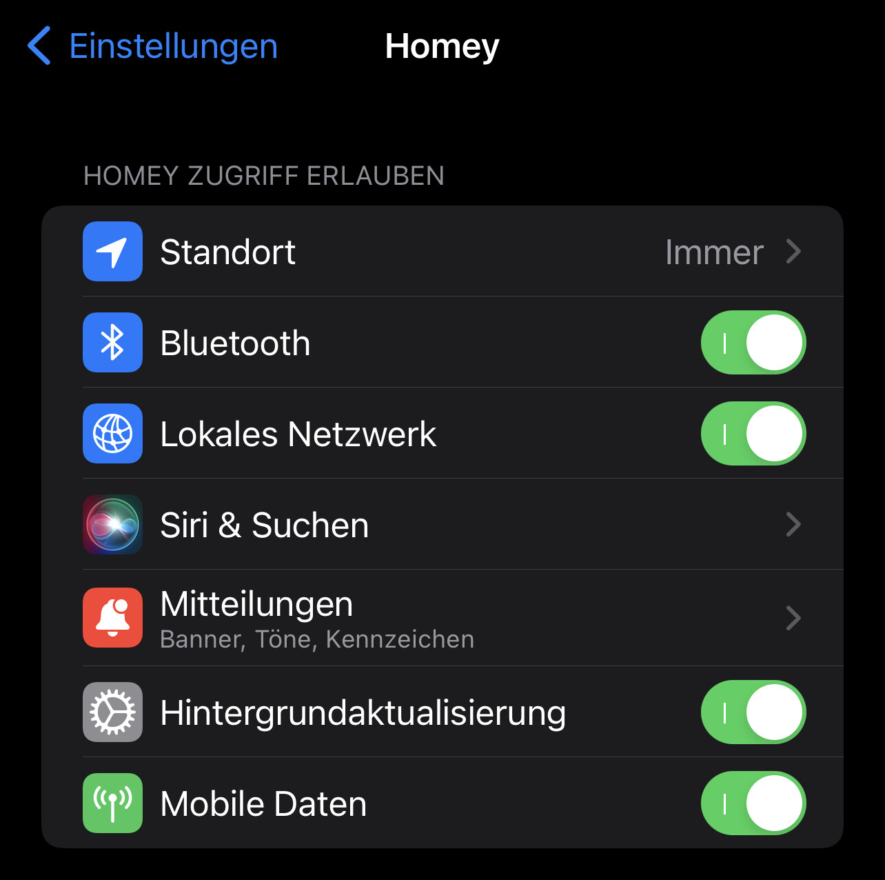

And these are the iPhone settings (sorry, only in German):
Do you have other geofencing apps installed on the iPhone which are working?
Have any updates been done?
Hi Fantross! Settings are same as photo.
In any case from yesterday everything start working again! I assure I did nothing but suddenly I came back home and I found the doors open. I tried a second Time yesterday and today and is working.
Now, I’m happy the issue is solved but I really would understand how…
