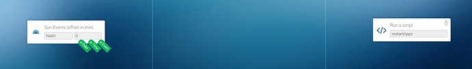

I must say I’m still running Homey v1.5 but below is the script I use to restart certain apps daily. You’ll have to check if this works for version 2.0 of Homey.
The homeyscript I use contains the following:
await Homey.apps.restartApp({id: 'magic.home.wifi'});
await Homey.apps.restartApp({id: 'com.swttt.homekit'});
await Homey.apps.restartApp({id: 'nl.scanno.mqtt'});
return true;
I called it restartApps.js
Then create a flow and trigger on a specific sunevent or scheduled time and run the homeyscript.
Hopefully you can recreate this for version 2.0.
