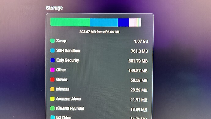

Was able to get Homebridge to start installing and I got a "failed to write (no space left on device) error.
Looks like it was right!
