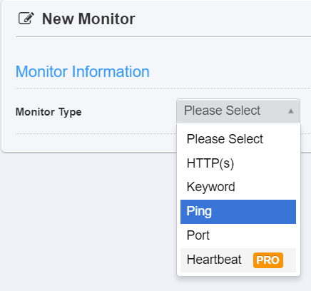

I have created an Account at UptimeRobot (https://uptimerobot.com/)
Create a Monitor and configure a Ping and/or http or other probe.
I created one on a High http forwarded port to a microserver at home Using an IP AND created one on the dynamicDNS (from my qNAP)

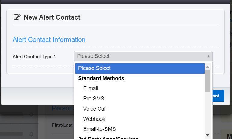

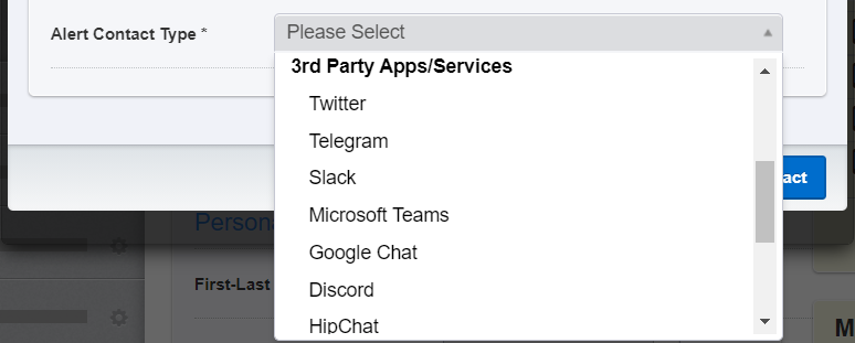

Set notifications to email, or one of the many other services.
Sorry, no need For Homey, but many options to connect I think.
I can see when Home is Offline (Both Down) or back but my dynamic IP changed. (fqdn OK, IP down)
Nice Graphs :wink:
Very cool and usable, Geurt!
