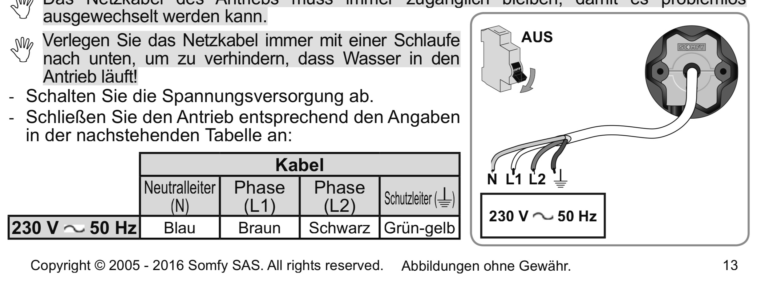

My window maker (hope, it‘s the right word :slight_smile: offered Somfy Motor Oximo 50WT SW 60 ED. According to the manual they work with L1, L2, N (see picture).

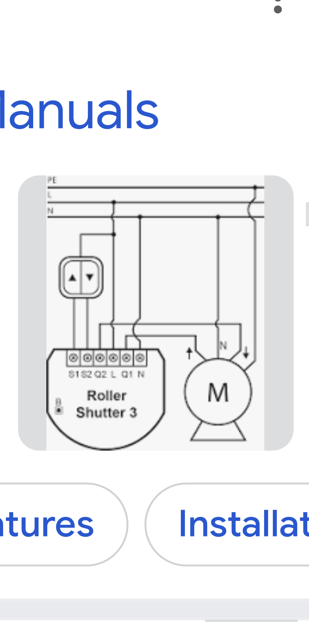

Can anybody confirm that these motors can work together with Qubino or Fibaro RS2/3?
Anything that speaks against these somfy motors?
No one who could provide a statement?
looks a perfect match, if you forget the right-most wire, not needed in your case.
