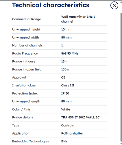

I received a new roof window from H&H today.
The remote control is a SIMU BHZ 1C.
I was hoping the old one would be compatible with the Somfy RTS app.
But it’s an 868 MHz device. How did you program your device with Homey?
Is the Somfy motor directly programed or is the remote control cloned?
Thanks for your reply.
As far as I’ve found here, it’s the “Somfy IO” protocol.
To control it, you probably need a Connexoon hub or something similar.
Then the homey app “Somfy-TaHoma & Connexoon” would probably work too.
I’d rather use the remote control then… :wink:
