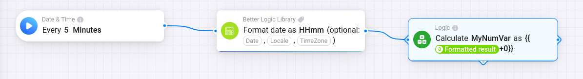

For you and anyone else interested, I felt like visualizing the BLL flow possibility in addition to the solutions posted here.
The BLL card ‘Format date as …’ returns the result of your entered format right away as you type:
To save the time without colon as numeric variable:

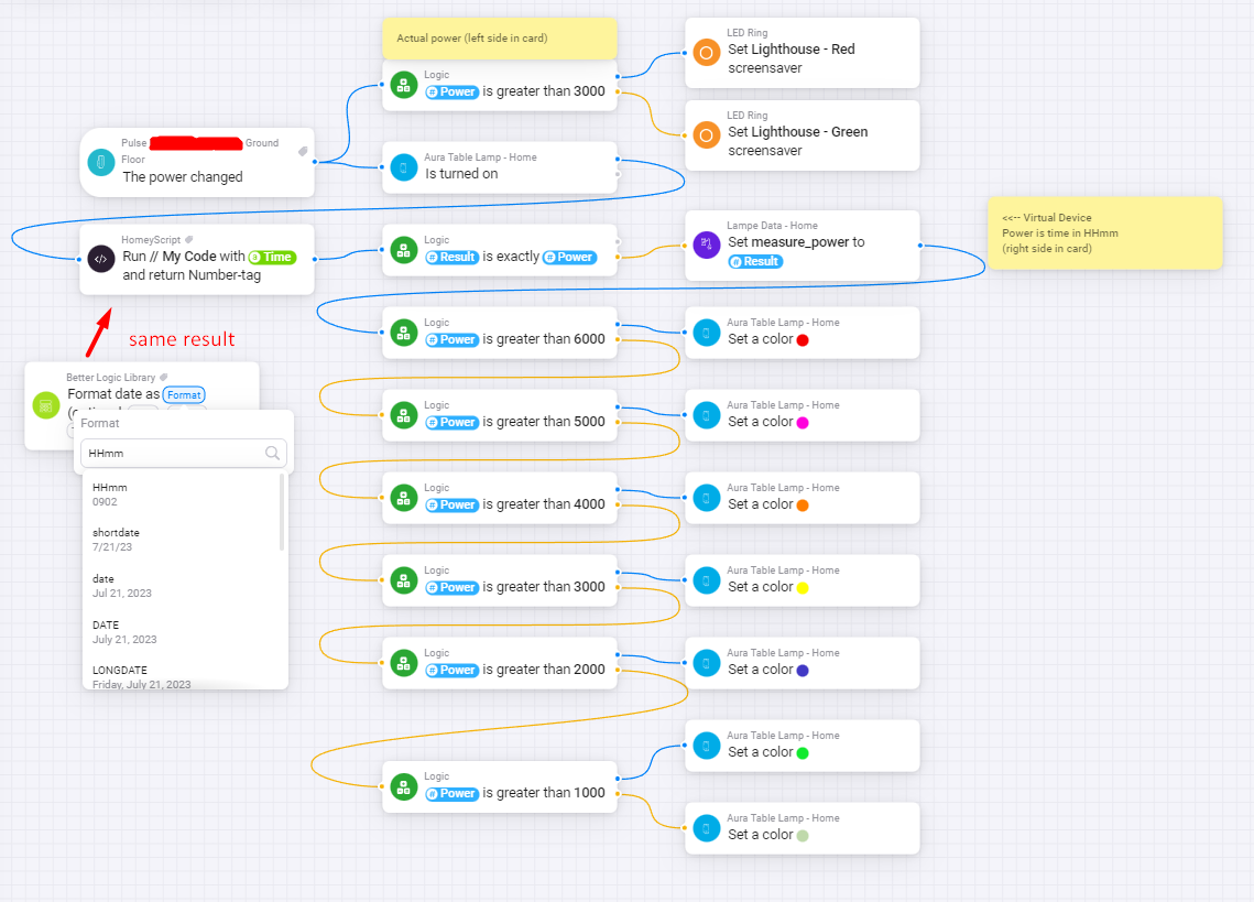

Below is how i used the homeyscript solution + how your example also could be used.

I ended up using the BetterLogicLibrary, as it turnes out i could not save a converted time with a 0 at the begining, like 0922. It would save it as 922. Using BLL i formated time using “m” not “mm”. If i understand this correctly, it will return a number as 5, instead of 05.
