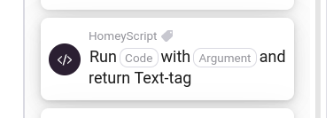

Use the following THEN card
Screenshot from 2023-04-26 21-22-07
Replace the example code at the [Code] part with:

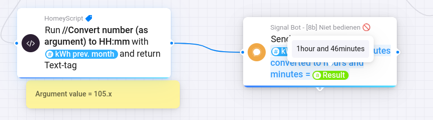

Then you’ll get something similar like this, use a numeric variable or tag of your choice (I used just a numeric variable) as argument (=input), connect both cards and use local [Result] string tag in further processing:
The minutes get rounded, to avoid f.i. 45.766666666666 as the minutes number
