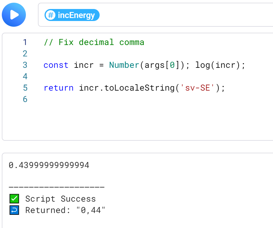

Image showing my code after test:

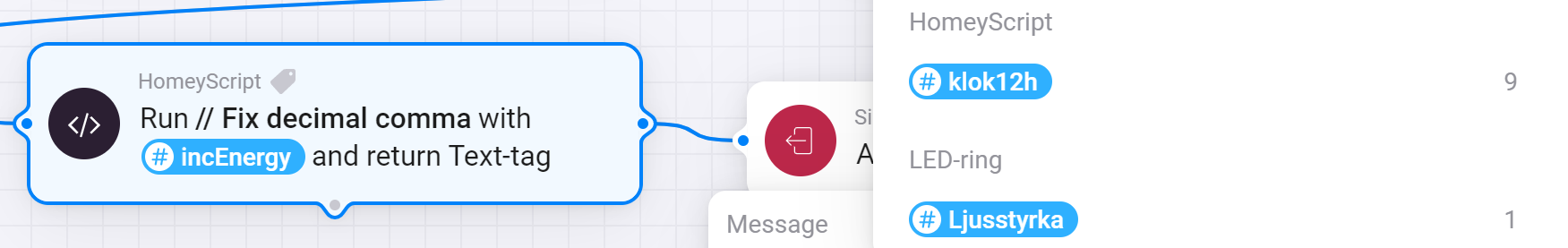

Image showing my trouble getting the recieving card to read the output of the code:
Note: The tag-name “klok12h” is kind of “glued” in this menu and reflects an earlier experiment of mine. The value (9) also made sense back then. I have restarted my Homey Pro but
#klok12h pops up anyway!

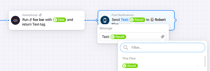

Try running the flow once, then see if the “Result” tag (which contains the result of the script) appears.
It has run many times, I use it to collect Excel data for my hourly power consumption (Swedish Excel doesn’t understand decimal points, only commas).
Am I looking for it in the right place (under HomeyScript)?
Ah, no, it should be under “This Flow”:

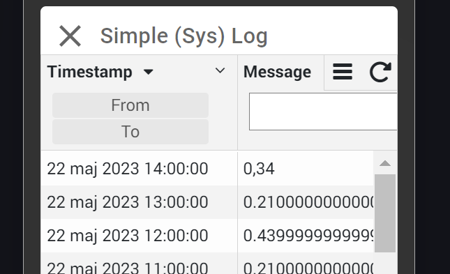

Wow, thank you very much!!! (Now I can’t wait to the 14:00 run!)
The 14:00 run: (YAY!)
