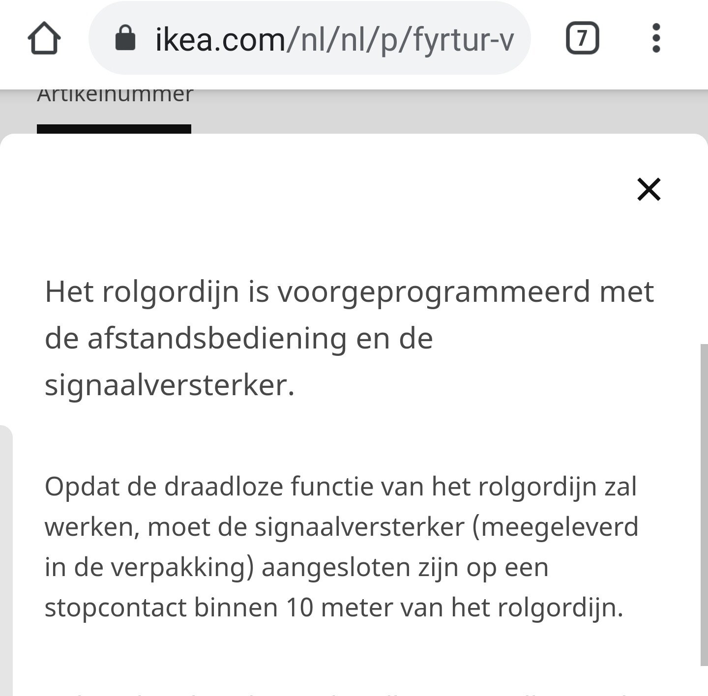

I checked the product page, each curtain comes with a mains powered repeater (it wasn’t clear to me how battery operated units could act as router as you described your situation)
So, if you connect all of them to Homey zigbee network and place 5 to 6 mains powered zigbee smartplugs f.i. in between, your aqara should be able to reach the Homey zigbee network.
Maybe you can place the curtain routers a bit smart to reduce the 30meters and reduce the need of extra zigbee router devices.
They say the nearest router should be within 10 meters, so you probably don’t need a router per curtain, and so you could place them along the house and towards the mailbox.
