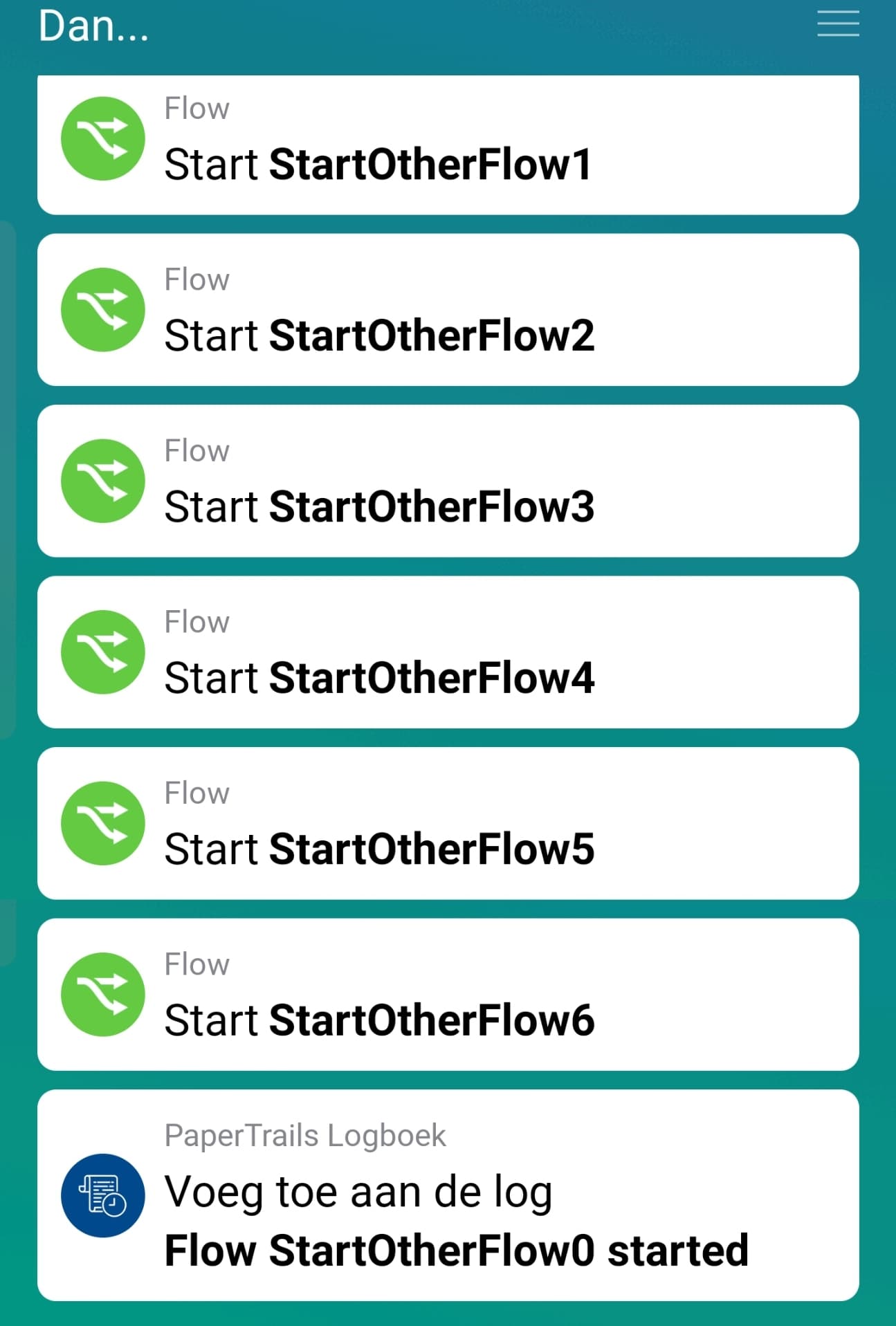

I did sort of the same with 6 flows, writing to the timeline
It takes here also about 0.5sec for the next flow to write a notification. I did several runs.
Also interesting maybe:
When I trigger 6 other flows at once by flow 0, there’s also a delay of ~ 0.5s, but not consistent.
Logged with Papertrails

I was also surprised about the “starting all flows at once” outcome.
I’ve read on the forum all action cards are fired at once with no special order.
But the Papertrails log shows the opposite…
Triggering flows using the same changed variable for all flows, doesn’t make much difference, the order and delays are a like.
It’s similar to ‘start all flows at once’.
