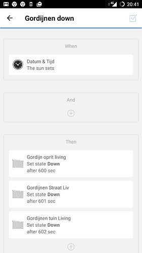

I find the homewizard tasks in many respects better than those “flow” of homey. Where I need one single Homewizard “task”, very often I need more than one “flow” using Homey.
An example:
I want curtains to close 10minutes after sunset. No problem for Homewizard, problematic for Homey. In homey, I am supposed to used timers, but they tend to overload the CPU.
Does anyone know how to realise the below function in one single Homey “flow”?

It’s a solution, but it will not win a beauty contest.
Every curtain has a timer running, again highering the CPU load .
Home wizard basically has this timer integrated into the first condition.!
Screenshot_20181224-204115|281x500
Could you create a flow that closes all the curtains and then run that flow from a timer. That way only one timer.
