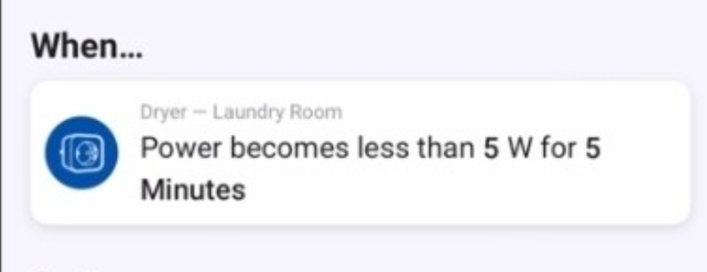

I have made a flow that tells me when the washing machine is done, but it often trigger upon turning on the machine. It is an older machine with a smart plug and is probably caused by a random drop since it does not always happen, but it is annoying.

I can choose this logic-card, but you can’t?
He’s referring to the newly introduced trigger cards, Wim:
So, this: When “value X is equal to 0 for 5 minutes", isn’t possible (yet).
For now, only greater/smaller than 0 (or any number).

What’s wrong with this card in your opinion? Any numeric capability should be supported:
