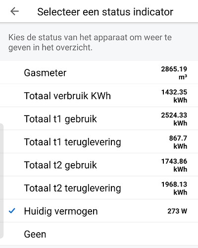

1st thing which pops up: Did you select the current power status indicator?
Else try selecting an other indicator, save settings, select the current power indicator again and save settings
