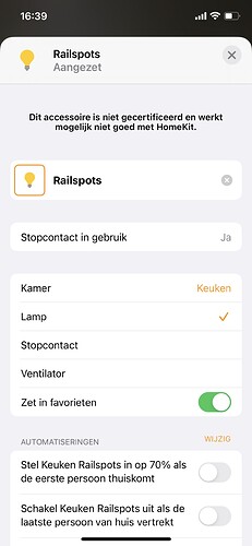

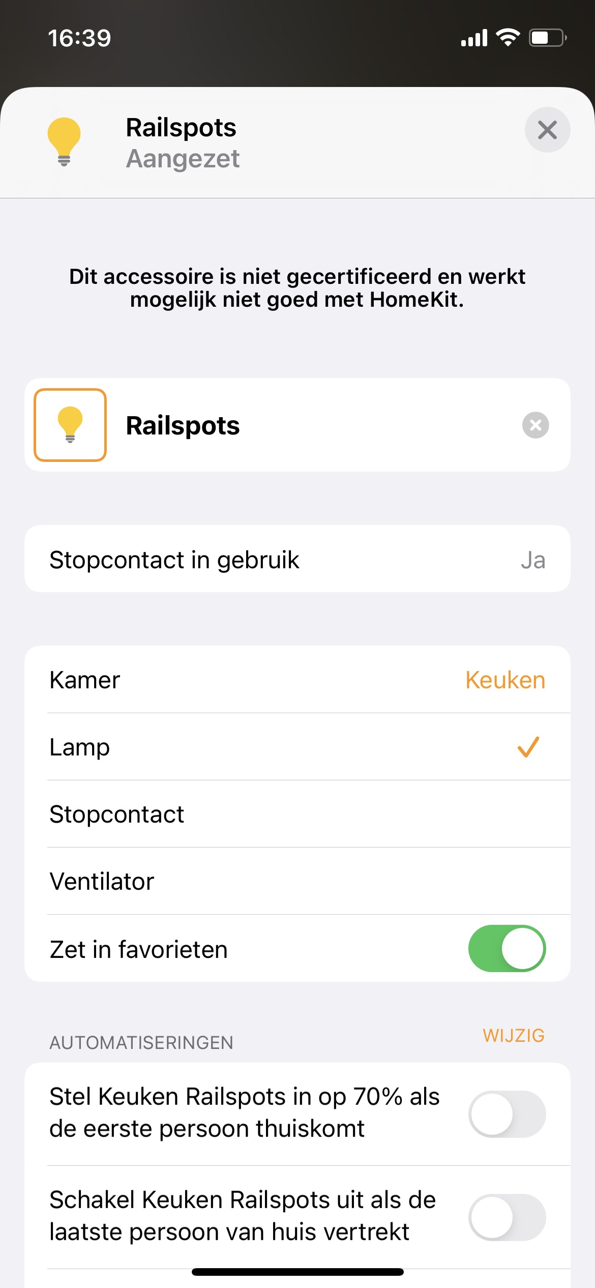

HomeKit see the device as a ‘socket’ I don’t know how to change this

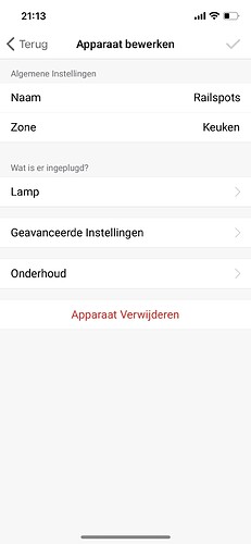

I found the problem, here is how to fix if someone have the same.
The reason is that the settings for the module in homey are not correct:
By the menu ‘wat is ingeplugd’ you have the set ‘lamp’. Basic setting is ‘overig’ and with that setting you can’t dim the light in HomeKit
