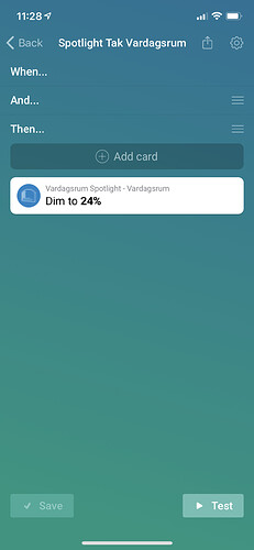

Share your flows, so we can advise
As I wrote, have a flow with set dim, but the problem is, if another trigger activates it goes to 100% no matter of the flow

OK, I guess, this flow is activated when the light is switched on by a manual switch?
For test purposes, you can add a delay on the Dim card of 5 seconds, to see if this works, if yes, make the delay shorter until it fits your needs.
In my case, when I start the light from a flow, I start it with a “dim%”,
When I start the light with the manual switch (pushbutton) it starts automatically at the same dim level as it was switched off.
Rem: the extra Off, is to prevent bouncing effects.
